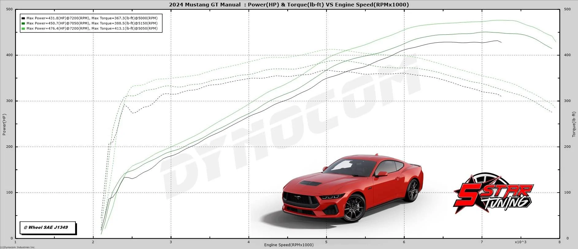

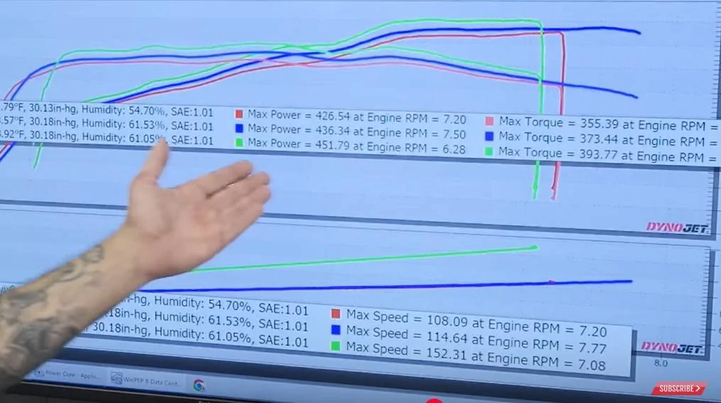

Where at? the PBD sheet they posted with Steeda stopped the run at like 71-7200
Looks like PBD ran it out to 7700.
5 Star to 7900.
Both are Manual's.
S650 Mustang Boschma's Speed shop tuned 24 Mustang 5_Star_S650_M6_7900
S650 Mustang Boschma's Speed shop tuned 24 Mustang PBD_S650_7800_Dyno
5 Star to 7900.
Both are Manual's.
Falls right off at 7400
10r80 gears are so close you're probably not gaining anything shifting much past that
The have a nice flat curve up top though
