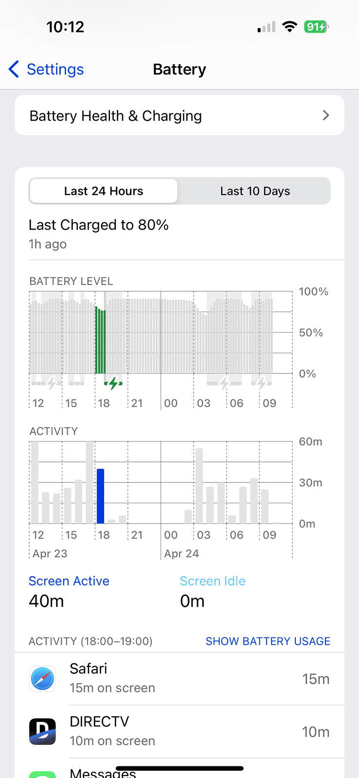

You can also see by hour (touch hour) which is using how much vs overall average.
Sometimes carplay is weird like, any chance pandora was the last place or audio you listened to via carplay? As in listened to audio using carplay and then switched to sync sometimes carplay takes over when it gets a connection.

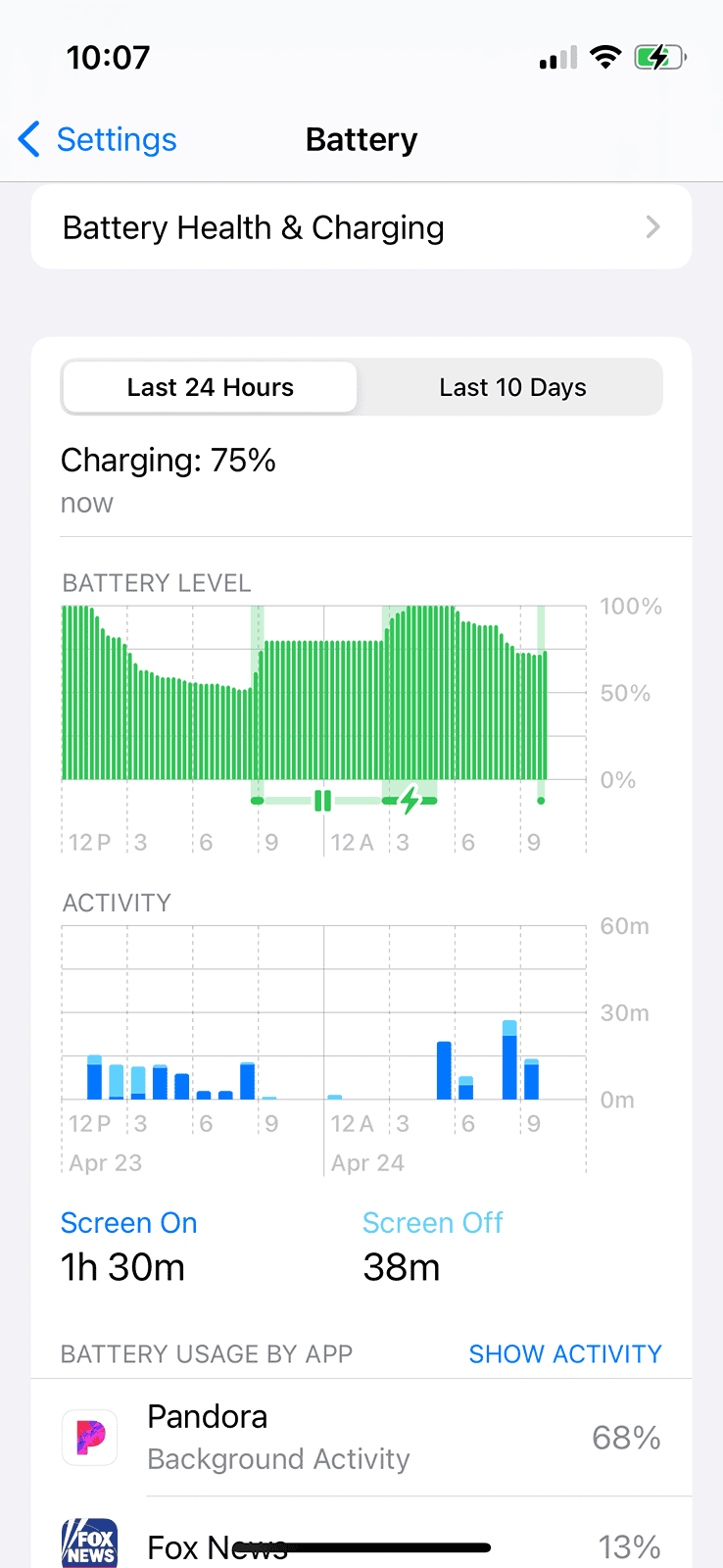

Tap a time slot that you are in the car to see what was running during that time.
Pandora pops to the top of the list.
