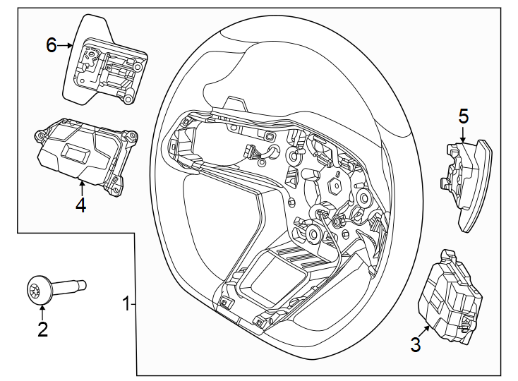

So far, people have been adding paddle shifters by buying a whole Dark Horse/GT wheel, either hoping to match your trim/features (+/- adaptive cruise), or switching over the buttons if mismatched.
However, I wonder it's possible to buy just the paddle shifter assemblies themselves + the backplate, to attach to the back of your existing wheel:
The paddles are:
PR3Z-3F884-AA (Right)
PR3Z-3F885-AA (Left)
#5 and 6 in the image below:
S650 Mustang Add paddle shifters - theory JC24425
Only ~$55 each, much cheaper than getting a whole wheel (~$400), especially if you don't want to mess with switching over buttons, mis-match to the Dark Horse dark trim, etc.
Anybody who's added paddles and could chime in whether this might be possible? I believe the paddle assemblies themselves have the harness to plug into your existing wheel and function.

I've researched this to some degree, but take my answers with some trepidation.
If you buy the correct steering wheel, it will not have any buttons, but it will have levers. Obviously, you reuse the OEM buttons and AirBag. The conversion does require the use of ForScan to change several parameters, and those have been listed here. A quick search should bring those up. Overall, it isn't difficult, but seemingly everyone has issues making it work the first time around.
I bought the DH wheel from Ford performance and it came complete with all the buttons. I made all of the Forscan changes necessary to enable the paddles with ZERO issues ..... In fact, changing to the Billet Workz shifter and the paddle shifters is THE mod the EB needed ....FWIW
I explored just changing / adding the paddle switches, but could not find any info on the doing the change. So ... I bought the DH wheel from Ford perrformance - on sale (20% off), used my leftover ford pass points, the wheel cost me 271.00 - sold my original heated (premium) steering wheel on e-bay for 150.00 so my out of pocket ended up being about 125.00.

I added paddle shifters to a non-paddle steering wheel. I also made the wiring myself, without replacing the original harness inside the steering wheel. For the rear plastic trim, I cut the necessary holes to fit the new paddle shifters.
