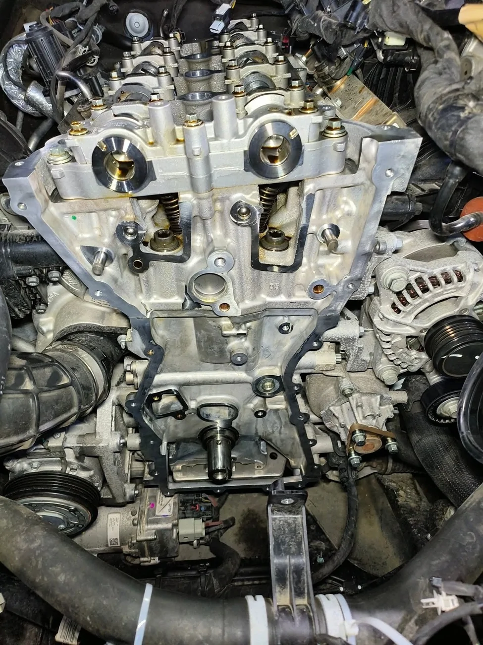

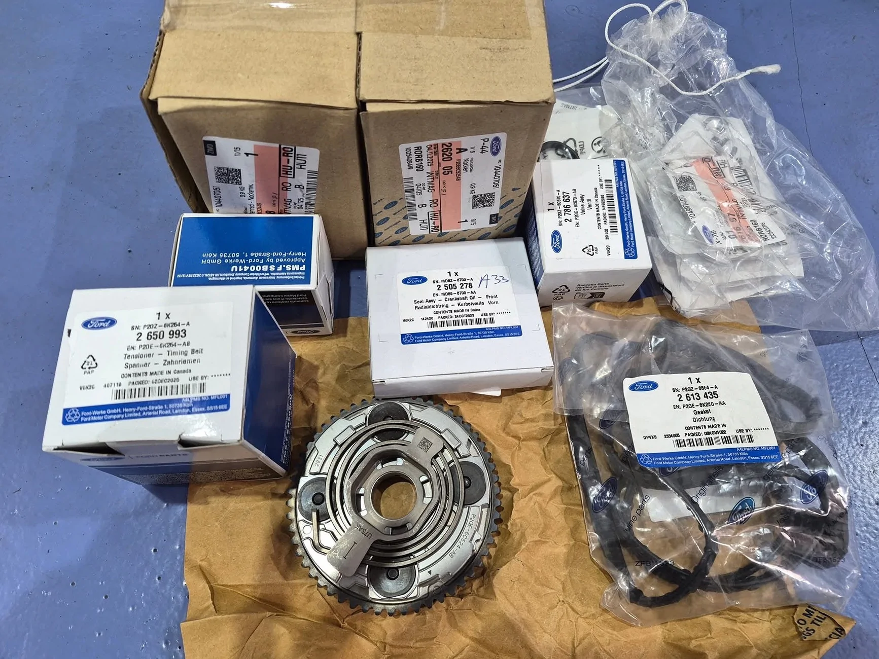

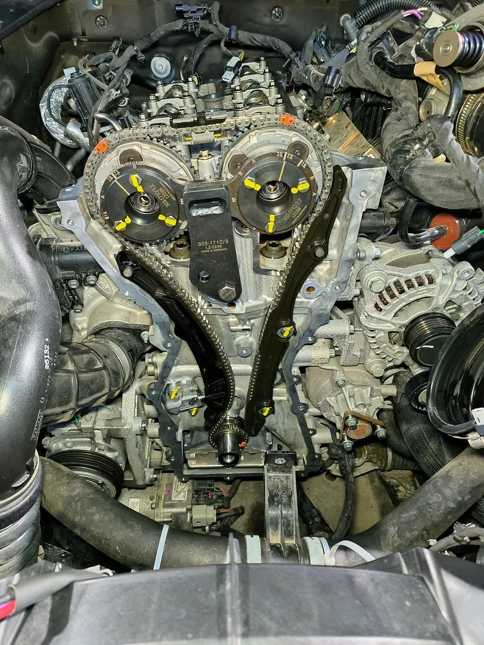

SergioDiego
Dec 29, 2018
Bucharest
2018 EB PP , 2024 Premium EB
Hi, did you discover the problem? I have the same sound. I have changed a lot of parts from the distribution but no luck.
