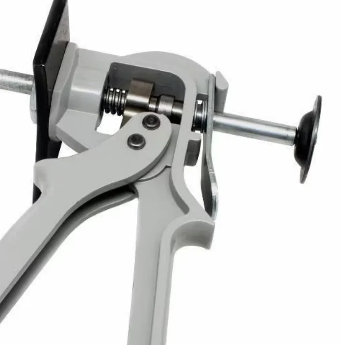

I used brake maintenance mode and got the calipers off, no need to “Twist” the piston back in, just apply pressure with a caliper spreader tool and it pushes back in. Tool below is what I used.
S650 Mustang 2024 Base GT rear brake pad replacement question IMG_0317
