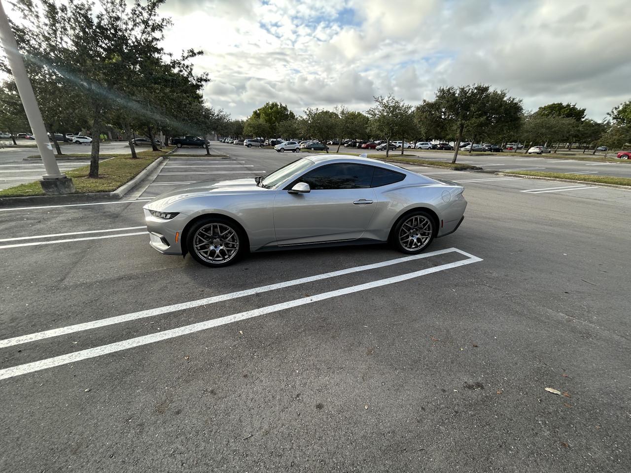

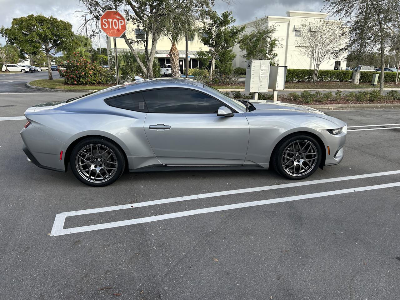

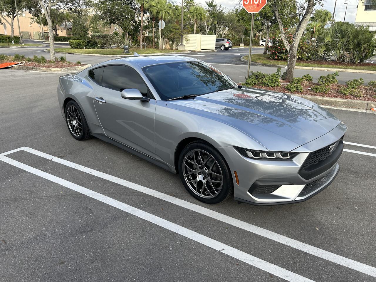

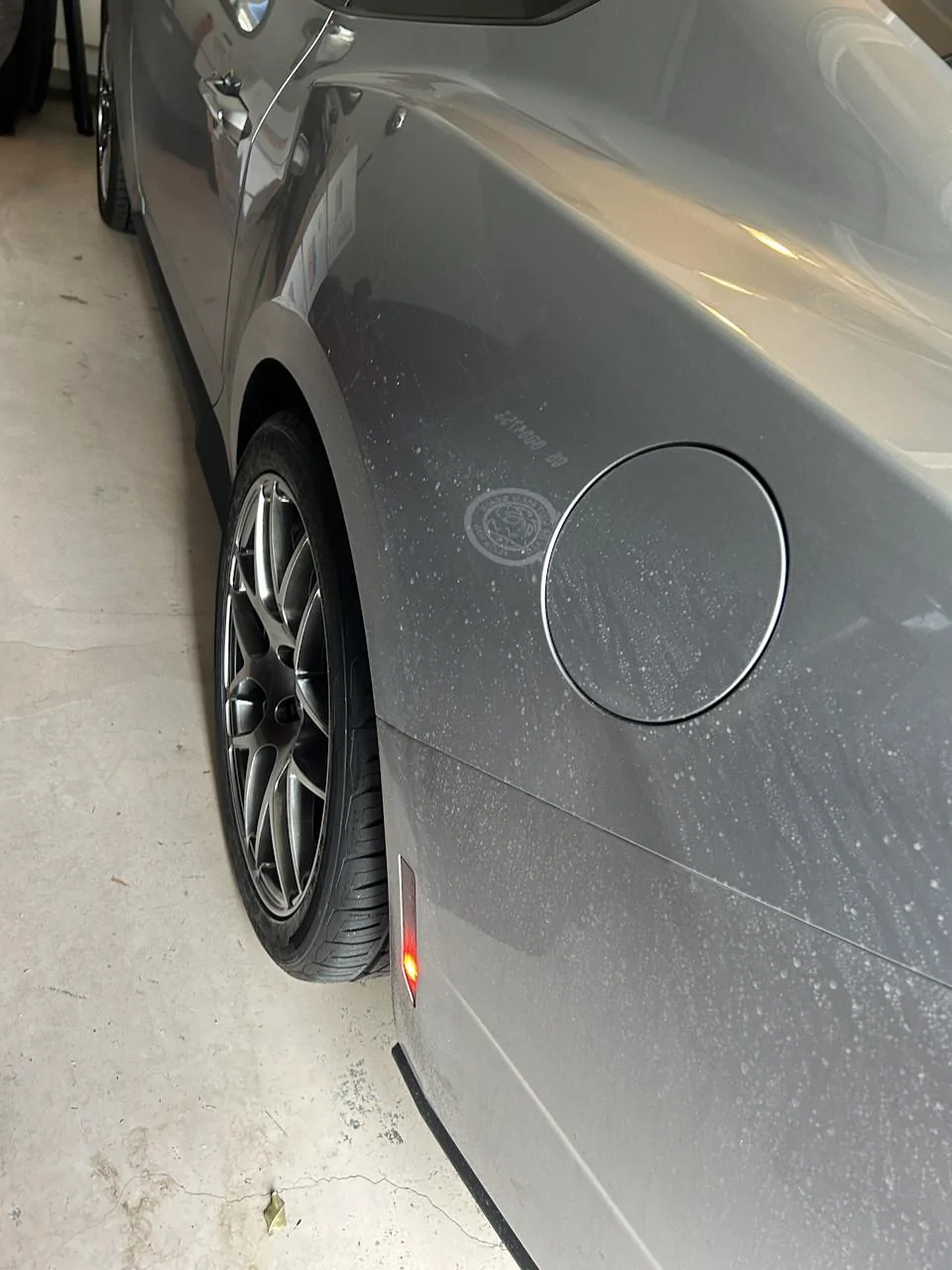

Hey everyone, these are from American Muscle, AMR Dark Stainless in 19 x 8.5". 30 mm offset, 5.932 Inch (150.7mm) backspacing. The tires are 255/40ZR-19 General G-MAX all around. I just assumed the fitment from the S550 would work, and it did no problem. I had the tire shop move the factory TPMS sensors over to the new wheels, and also bought black lug nuts. Total cost was about $1600 for everything installed. Anyway, hopefully this helps someone! Car is a base Ecoboost that had the hideous rental car style 17's on there before...

They look good

Thinking of upgrading my EcoBoost 18's to something like these in a 19. What is the ramafications of doing so? Does it throw off the speedometer or other mechanics in the car?

As long as the overall diameter of the wheel and tire combo is the same, it will not throw anything off. All I did was find a set of wheels known to fit the s550, assumed they would fit the s650 (which they did), and then just matched the factory 19" tire size. The car actually feels even quicker than it did before, I noticed that immediately. I suspect the new wheels/tires might be a couple pounds lighter than the stock ones were.

I really like those!

Nice upgrade for sure!

So the color or your base EB is Iconic Silver correct? I think the Silver color on the Mustang was called something else previously. I saw the pic of your car when you first got it with the base 17" Aluminum wheels and man or man what a difference a set of wheels makes.
I ordered a base EB in Iconic Silver about a week ago and I'm pretty excited. It looks like the base wheel size is now 18" and IMHO the base 18" wheels look really good and are much improved over the 17." I think this is a recent change but I'm not complaining.
Anyway you have a great looking car and IMHO it looks stunning in Silver. Looking forward to receiving mine in time for summer:)
