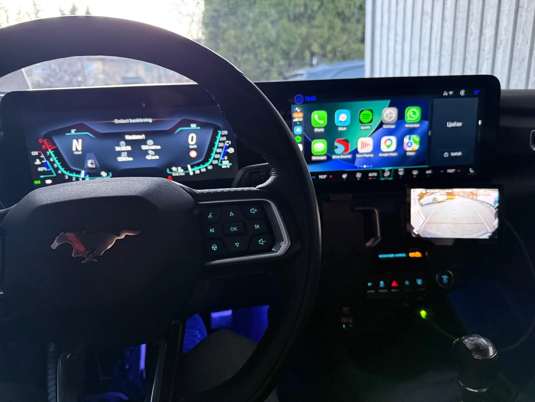

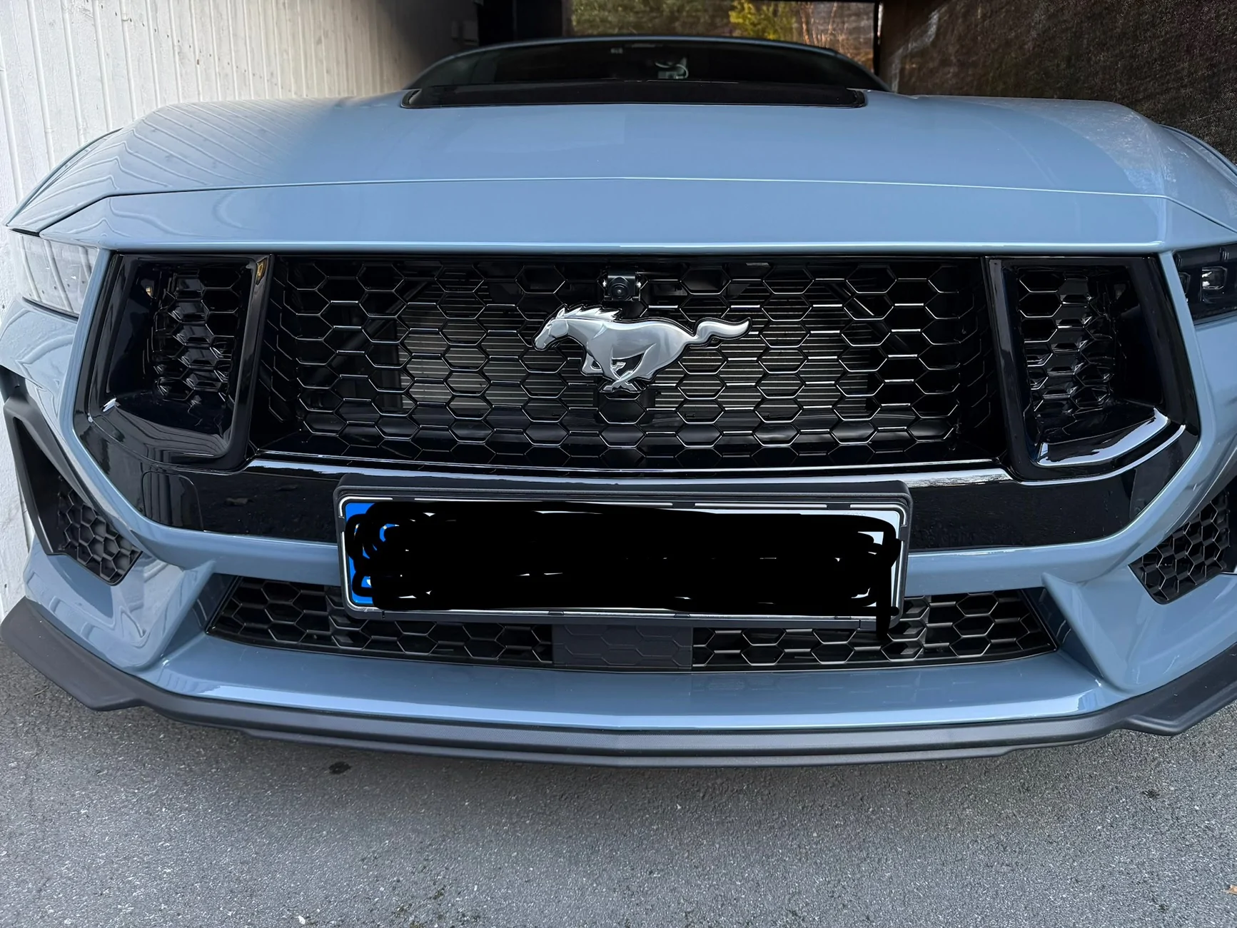

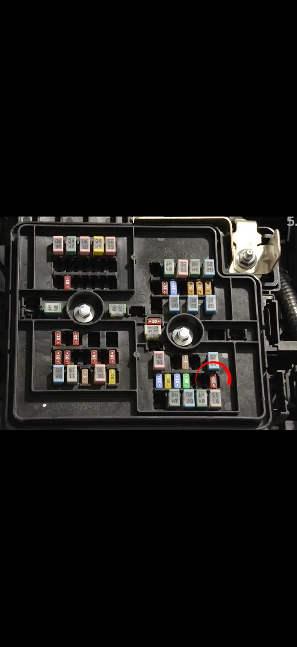

Just installed a Garmin BC50 as a front camera. Used fuse number 51, see picture.

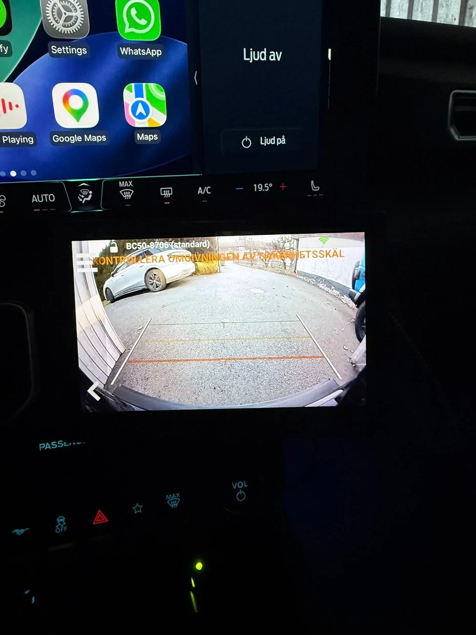

When I need the front camera I now turn on the rear heated window and it’s live. The connection between the camera and the GPS is wireless.
I’m using the Garmin Drive 53 GPS as screen.

Very nice indeed. Good job. Is it tied to the Garmin screen? I mean can it work on like a stand alone screen?
