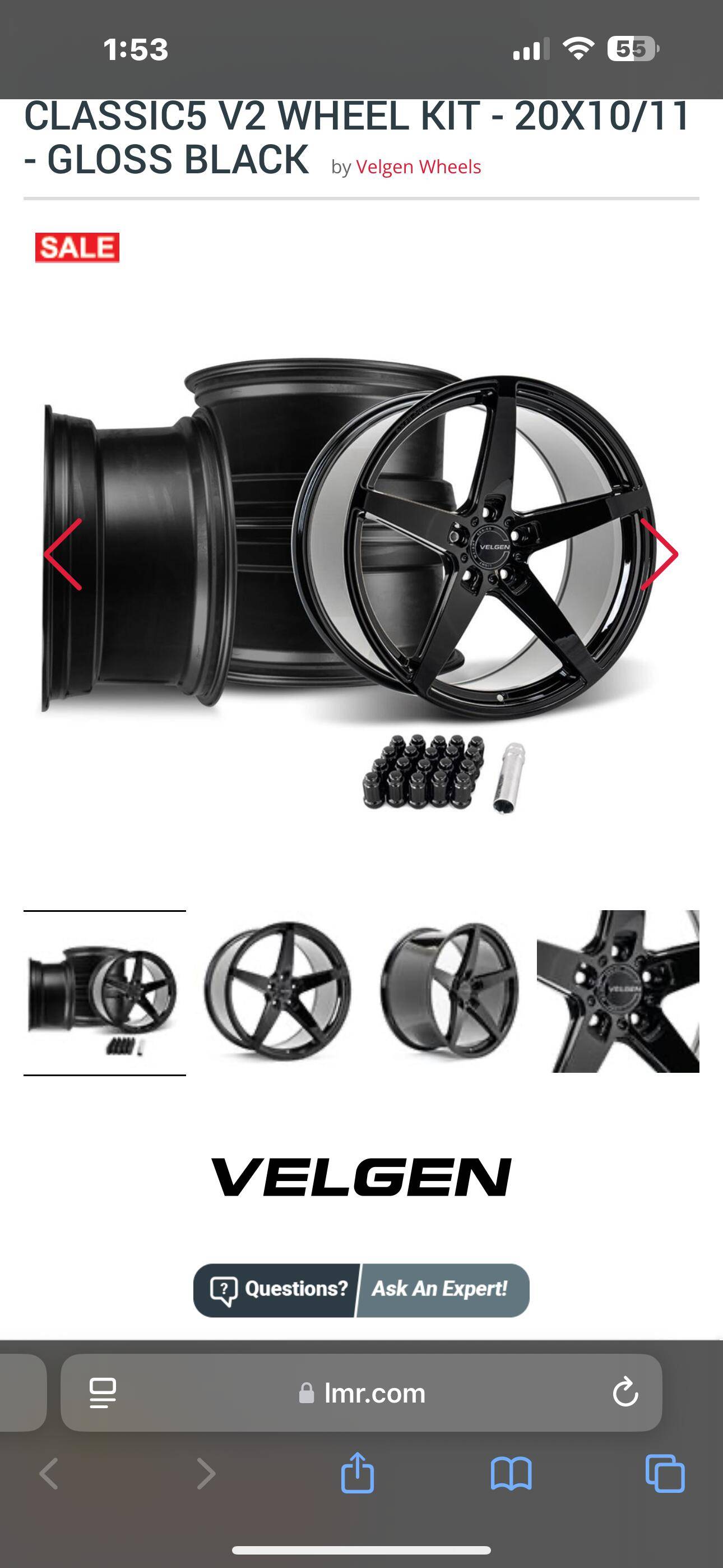

So I just pick up a set of VELGEN wheels from LMR and wanted a wider back tire but not sure on sizes… I been looking around but still it sure… any help?

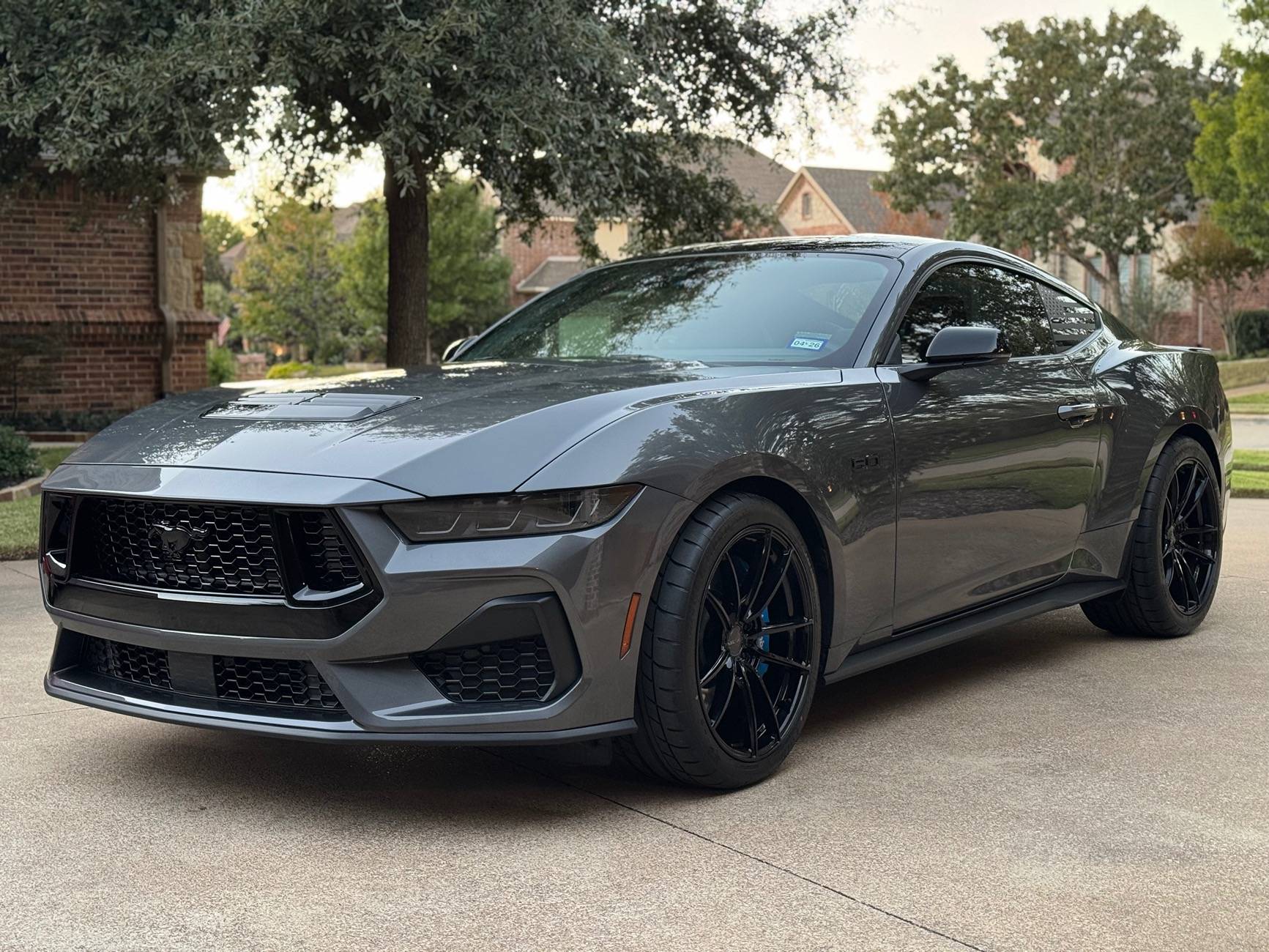

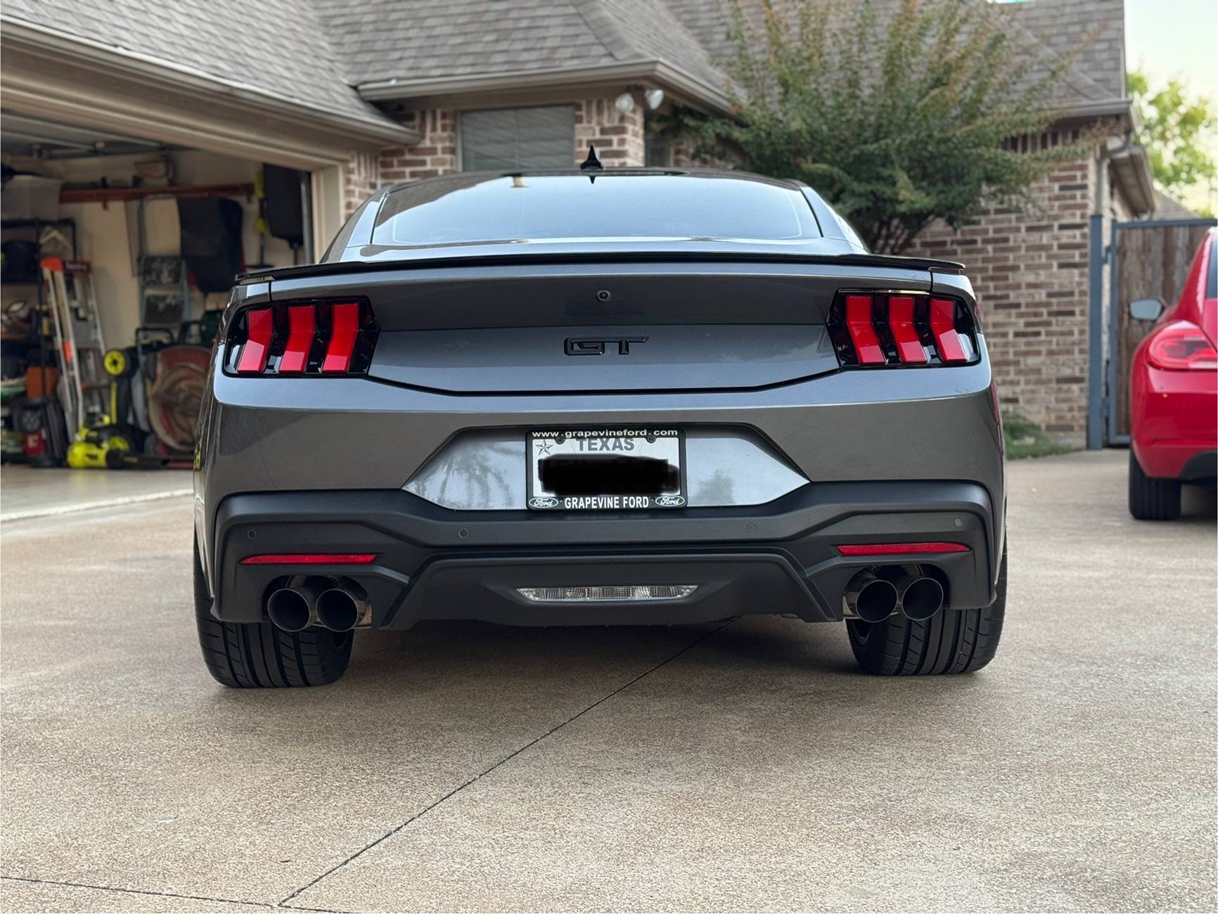

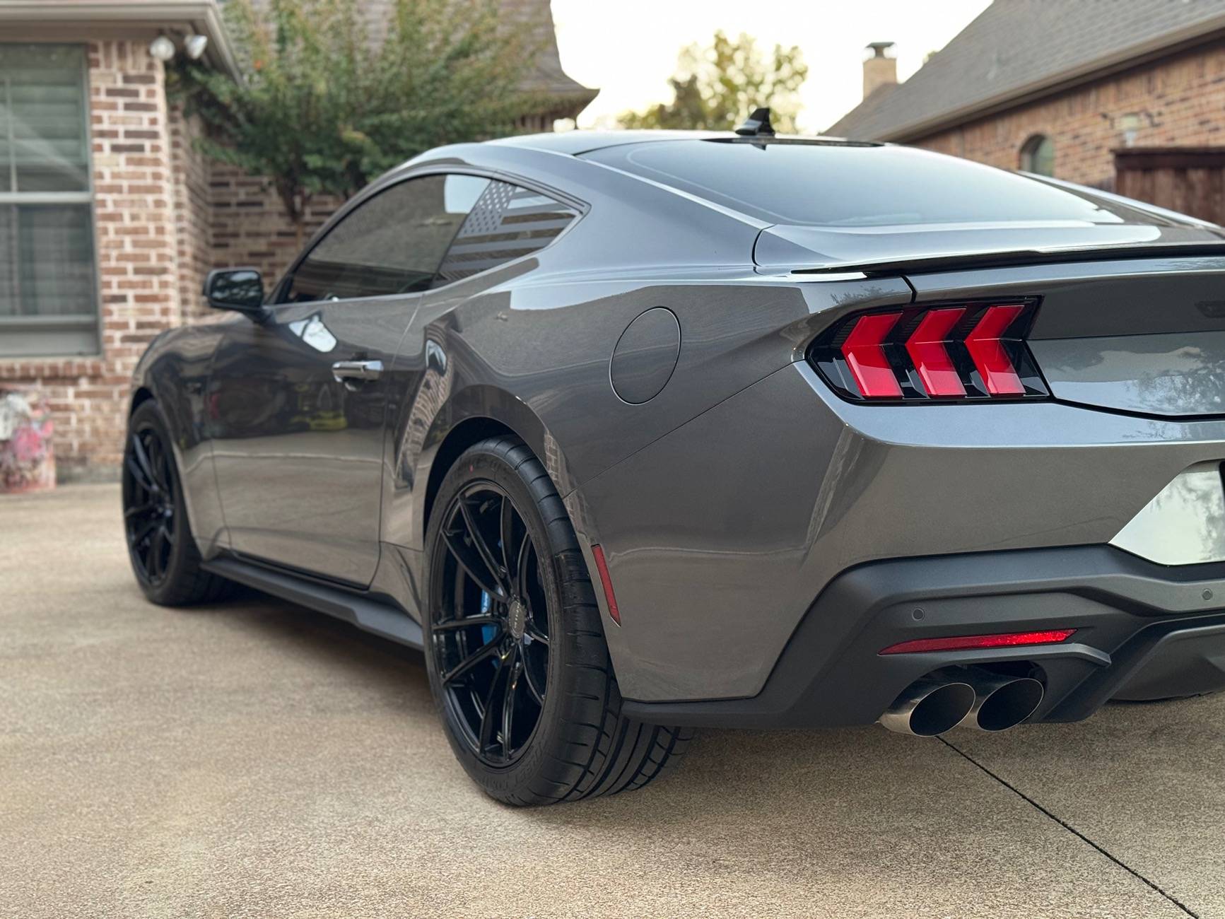

I’m running a similar setup with Velgen VF5s. I have 275/35s on the front and 305/35s in back. If you look at LMRs Velgen wheel and tire packages you get an idea of what will fit. I believe you can go up to 315s on the back without modifications.
