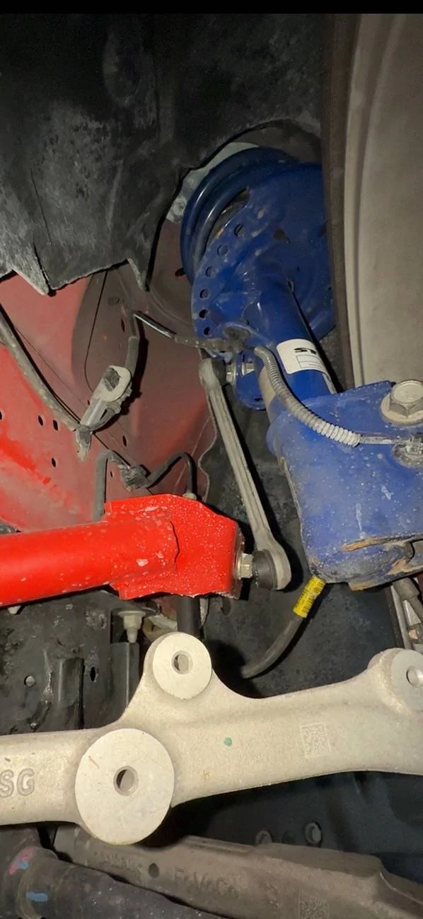

Just installed some BMR swaybars about a month ago. I was under the car today and saw that the swaybar end links aren’t vertical/on an angle and look to be to long. I have ford springs, steeda shocks and struts and BMR swaybars. Do I need adjustable ones? Why is the end link at such an angle?

I just got the BMR adjustable ones. HUGE difference in them compared to stock. Plus you can fine tune them to fit at the right angles and get rid of sway bar pre load. Plus, discount code zander7 will save you some cash. I honestly feel like these are a worthwhile upgrade even for stock bars.
