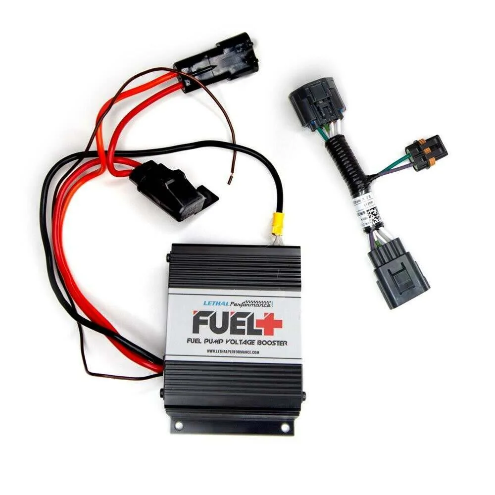

The stock upper for the 6 rib setup is a 3.85" I believe. If you go with a 20% lower and a 3.75" upper on a 10 rib setup I believe you'll be in the 18psi range. Every 1/8" in pulley size changes boost by about 1psi.
You're going to need to run better fuel than 93 and a fuel pump booster like our Fuel+ for anything smaller than a 3.75" upper and the stock lower. E30 works great but again will require a Fuel+ to run safely.
https://www.lethalperformance.com/l...ump-voltage-booster-2011-2024-mustang-gt.html
