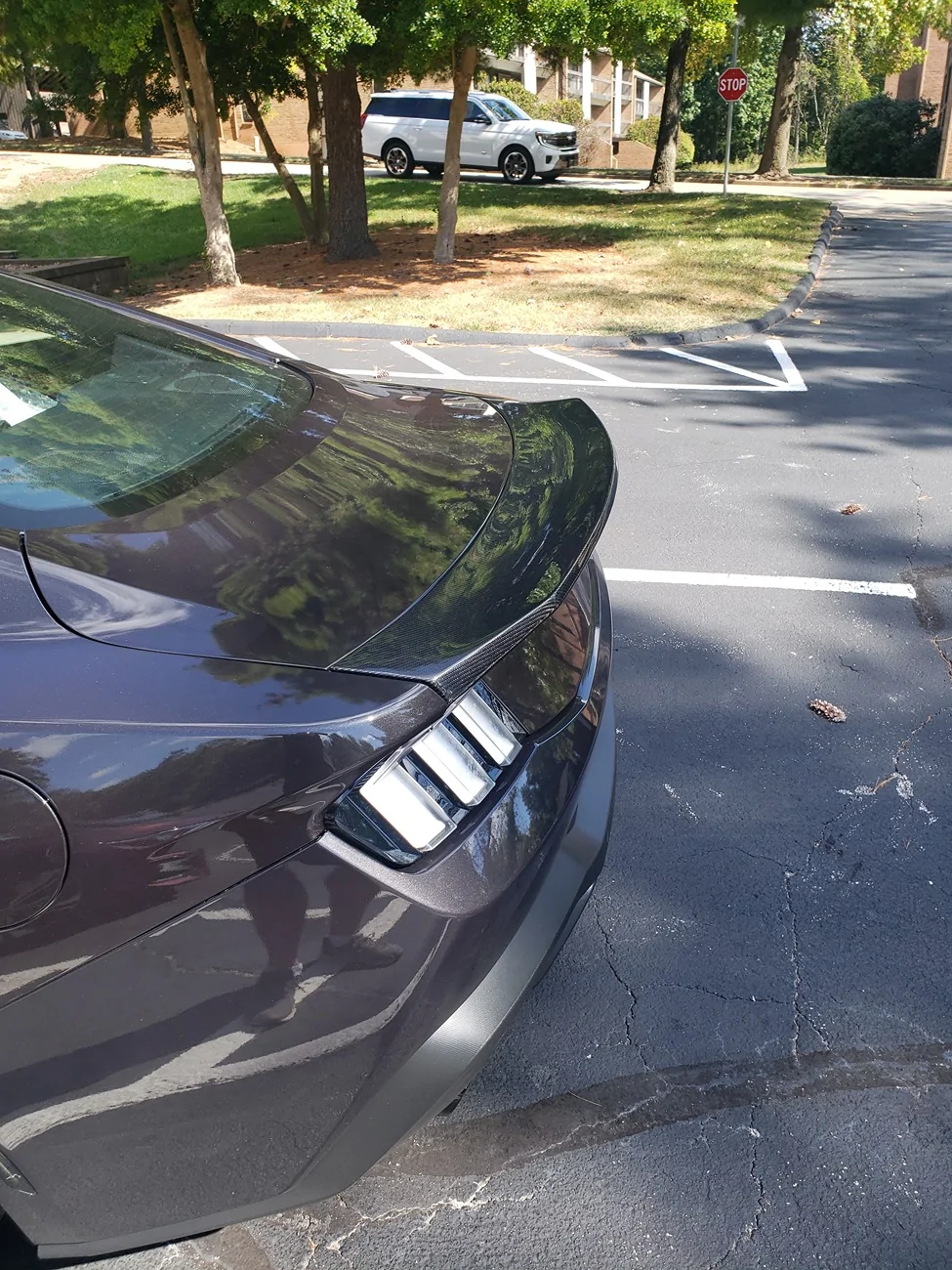

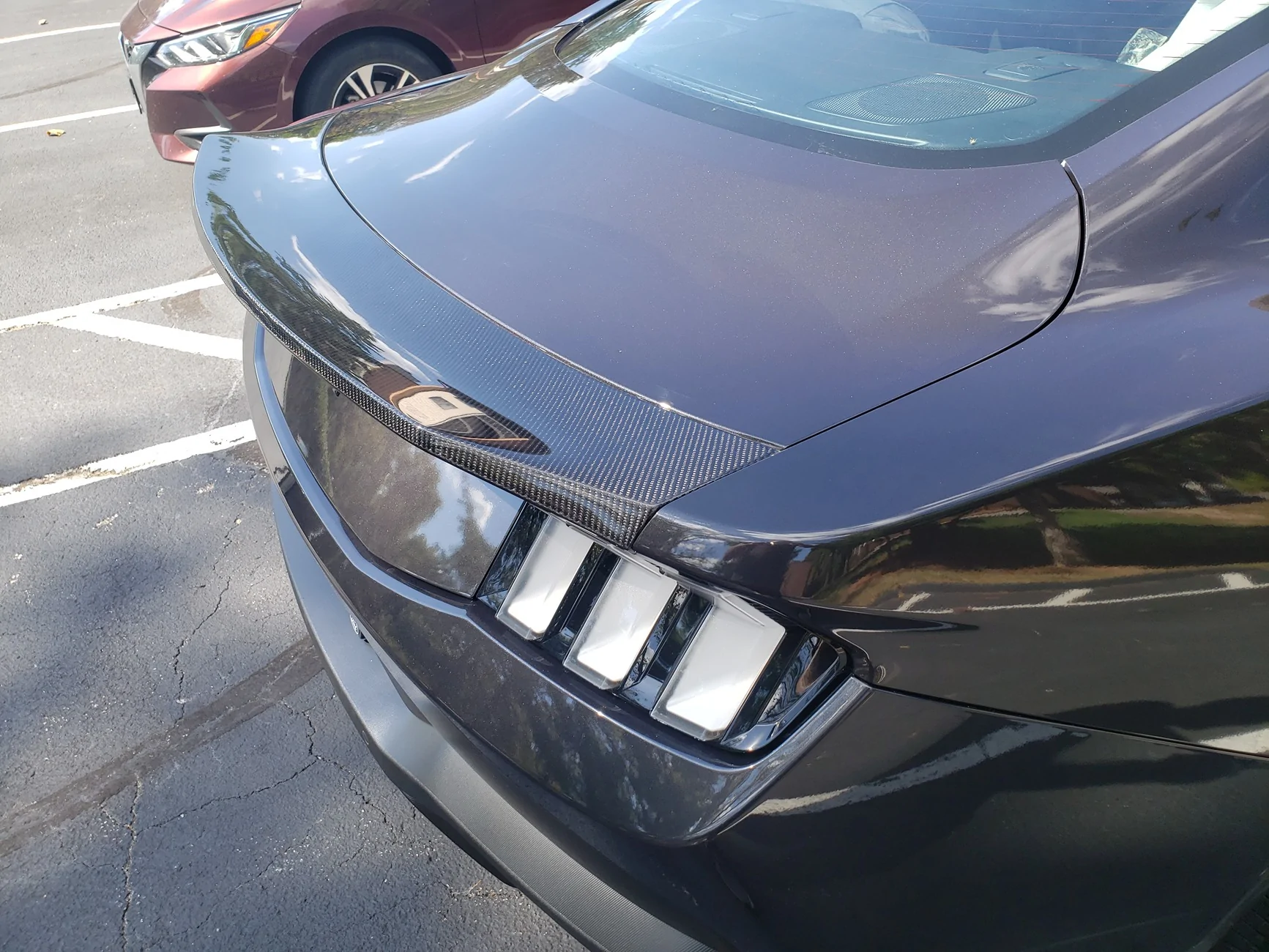

I put on an OEM PP spoiler that I found on ebay which was race red just like my car. Installation was as simple as removing 6 bolts, 5 nuts, christmas tree clips, camera, and transfering studs from original decklid to new. I think it took about 45 minutes because I had to take it all back apart to install the 7mm bolt inserts from the original decklid. I am going to have it, the mirrors, and the roof wrapped in gloss black to get the night pony look.
