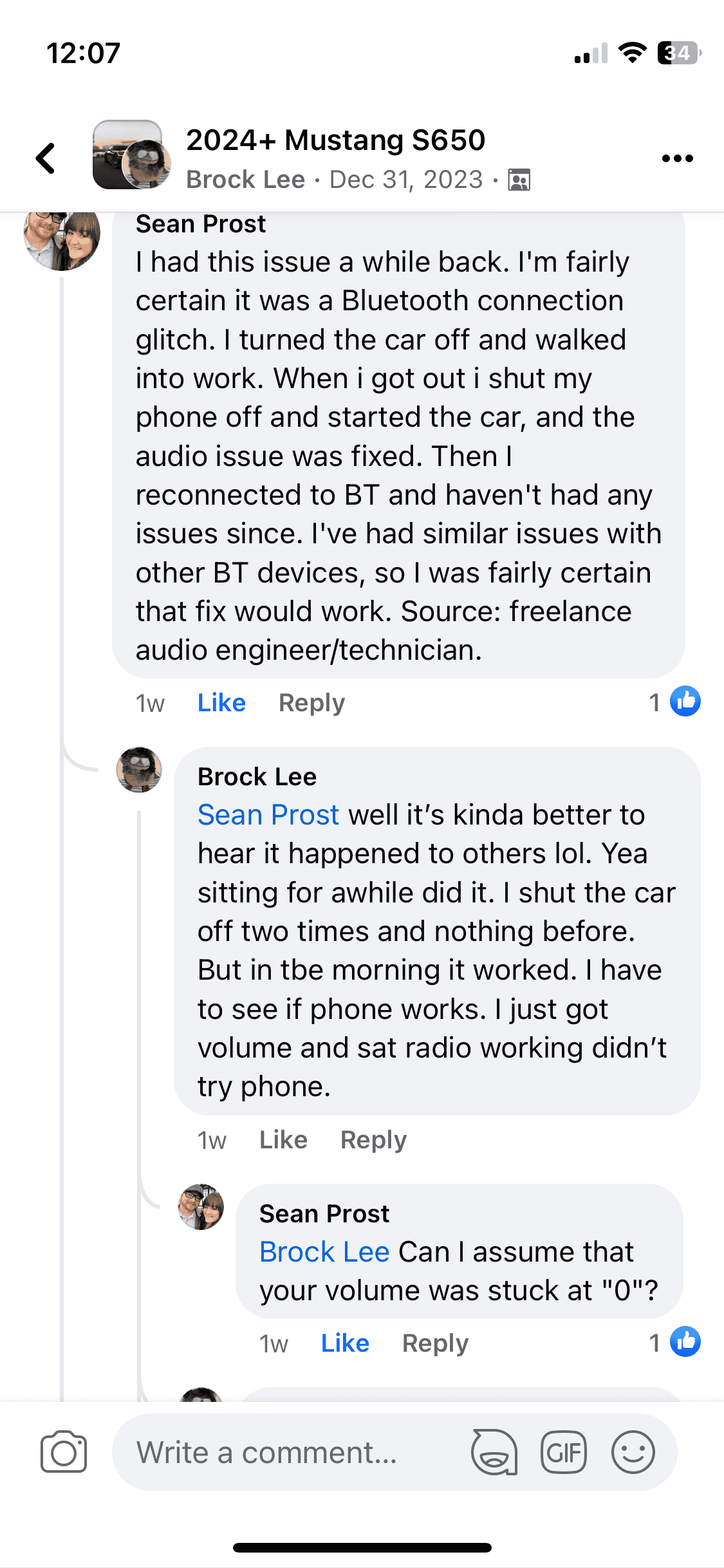

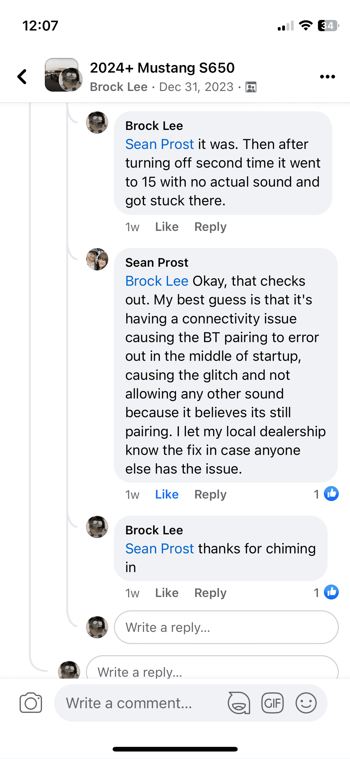

ive got it back. Someone brought up and issue with blue tooth and phone connecting automatically on FB. I reset all that because i did lose sound again after i had it back. But I may do this just to get any bugs out maybe

Mine is working. I didn’t reset anything though. I did reset Bluetooth settings even though i got sound back because of this convo.
