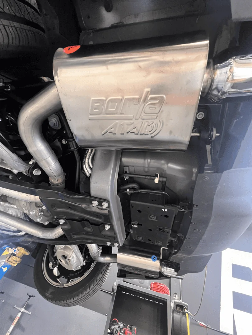

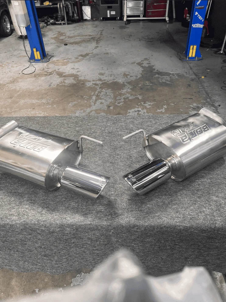

Axle back Borla ATAK exhausts

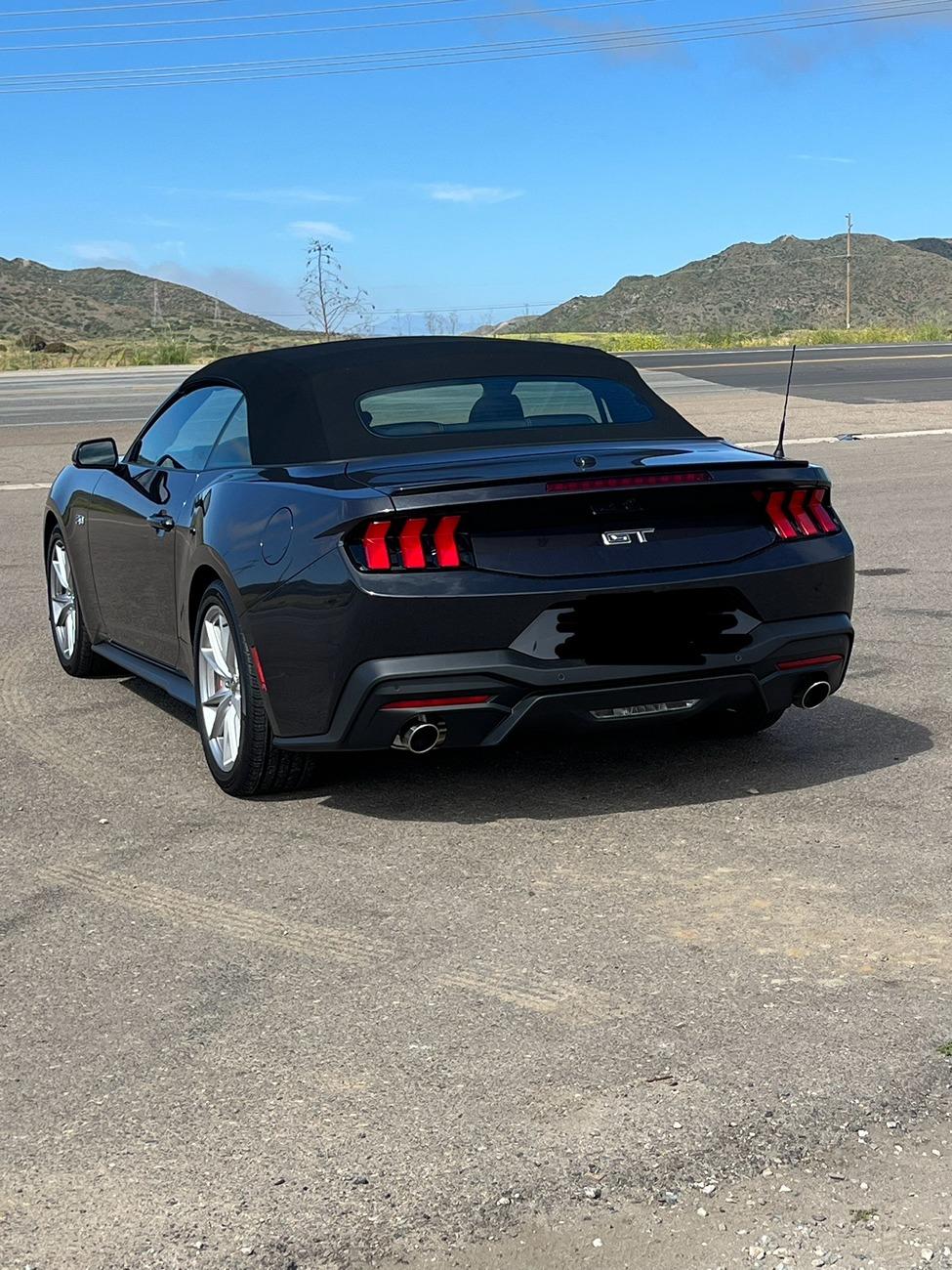

Top up, I'm really digging the rear, (Not what you think lmao)
I find it beautiful with the original spoiler. Clean and elegant.
The V8 sound is amazing and this exhaust fitted great. The only thing I like from custom exhaust is that you can choose one that fits you sound criteria.

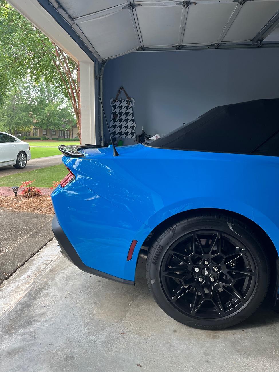

Nice looking Stang. Here’s a pic of the DAR spoiler on mine. It a great pic
Was that a drill free spoiler? I got the pp and am looking for low profile spoiler that is drill free.

Do you by any chance have the website that sells the spoiler? and you also have more pictures from different angles of your spoiler?
Yes more angles please! Really interested in this spoiler, the options are thin for verts.
