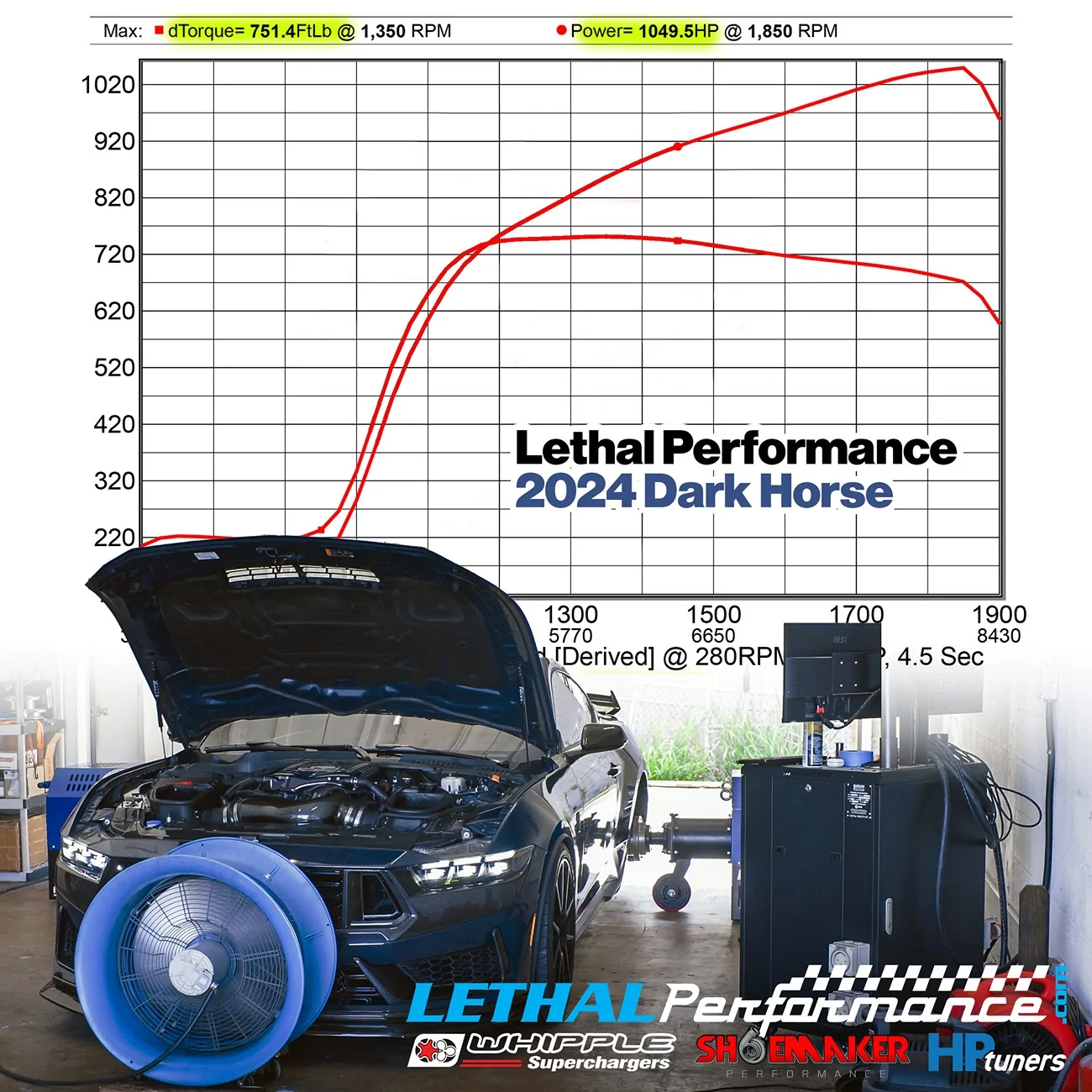

Our 2024 Mustang Dark Horse hit the dyno at Area 51 Motorsports, laying down 1049.5 rwhp and 751.4 ft-lbs on E85.
  • Lethal Performance Edition Whipple Gen 6 3.0L supercharger
  • 3.50" Griptec pulley
  • 10-rib kit w/ ATI 20% balancer
  • 1300lb Injector Dynamics injectors
  • KPM 1500hp Fuel System
  • Custom E85 tune from Shoemaker Performance
  • 20.7 psi peak boost
  • Stock headers, stock motor
Next goal: 8-second passes (when Florida weather cooperates)
Full build breakdown: lethalperformance.com/builds/dark-horse
