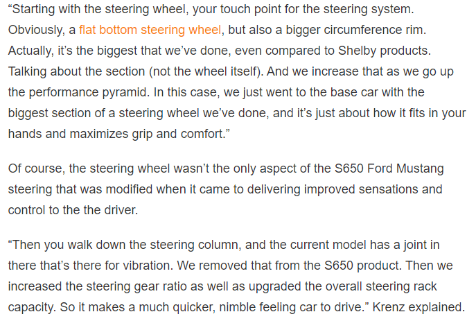

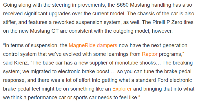

Love that write-up! Sure hope they got a better braking feel than on an Explorer. 😉 Can't wait to experience the differences.

some info
front and rear MagneRide struts/shocks are the same, it's the main computer that got upgraded, but the non-MagneRide struts/shocks are brand new.
front knuckles and hubs are brand new, rear knuckles are new, but the hubs are existing unless you have the carbon fiber wheels, then they're new.
most all sway bar parts are not new.
front subframe is new.
rear lower control arm is new.
pretty much everything in the steering column is new, but there's still 3 universal joints.
so many parts are new that its not safe to assume anything at this point, but i'm hoping that old wheels and stuff still work with no issue
