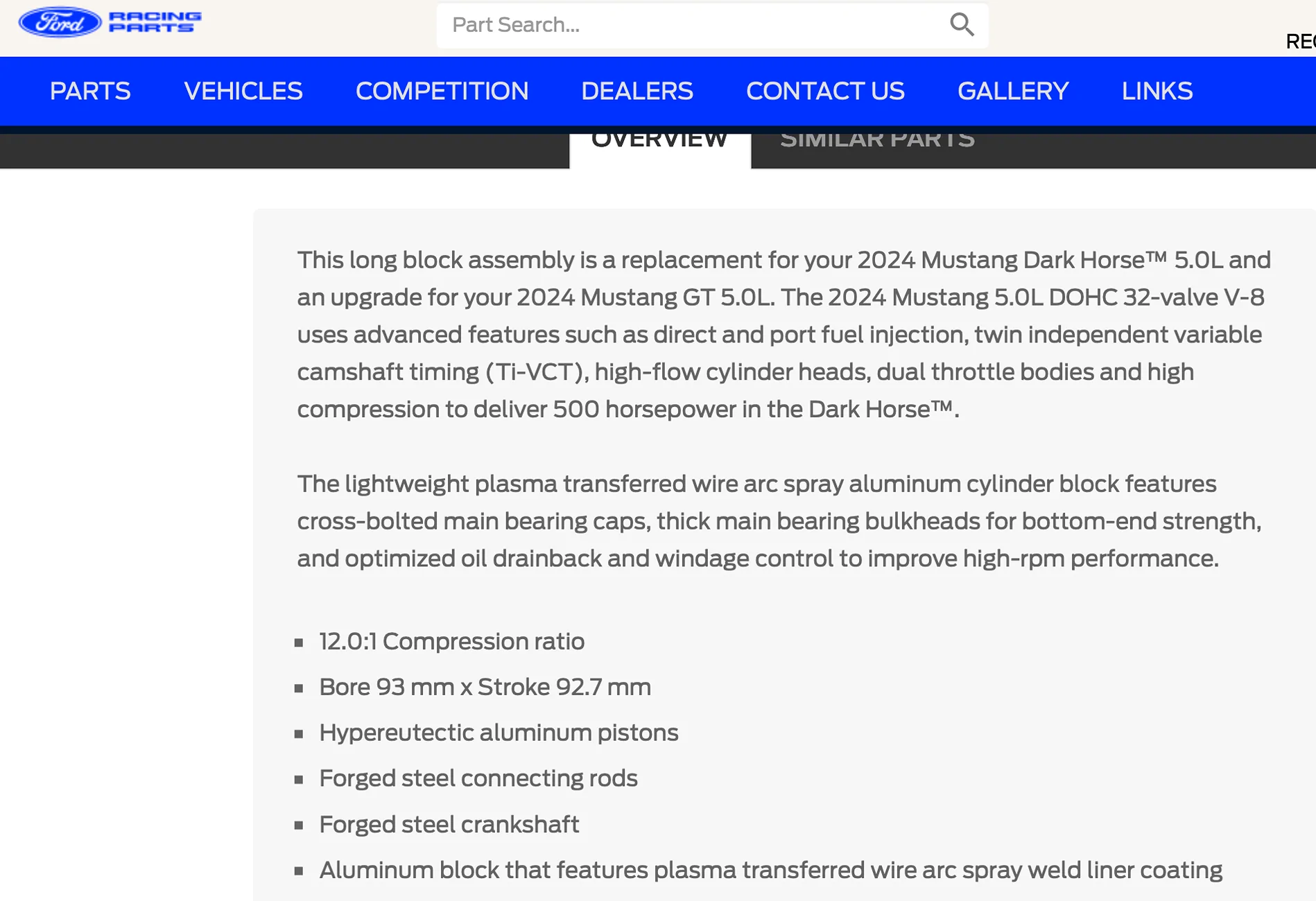

And yes, they are selling the new GEN four long blocks rated at 480 hp
2,820
2,807
Yes, according to Ford, the dark horse does have forged pistons and rods, although they use the weaker GT500 rod rather than the manley rods in their short blocks.
No it does not have forged pistons.
