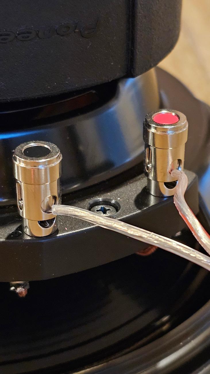

Ok, I see how the terminals / binding posts on the subwoofers work. Didn't realize they were spring loaded push pin style.

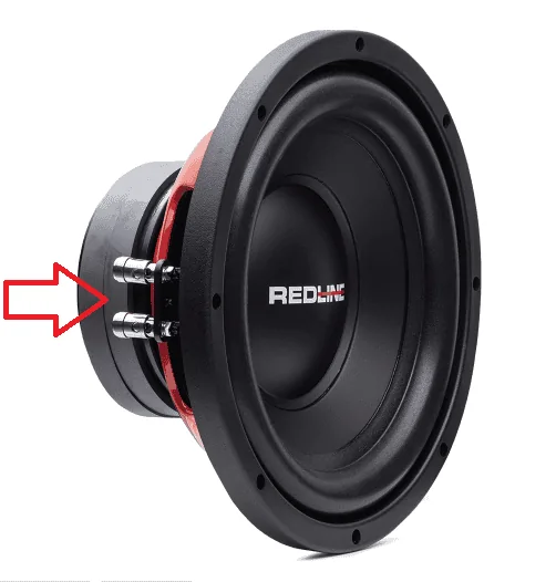

Maybe this has been asked already and I missed it.
Both the Pioneer and Redline have same type of connections on the subwoofer (PIC 1). How are the suggested aftermarket connectors (PIC 2) attached to those connectors on the subwoofer, as the connections are totally different?

Just need to snip off the connectors on the aftermarket adapters

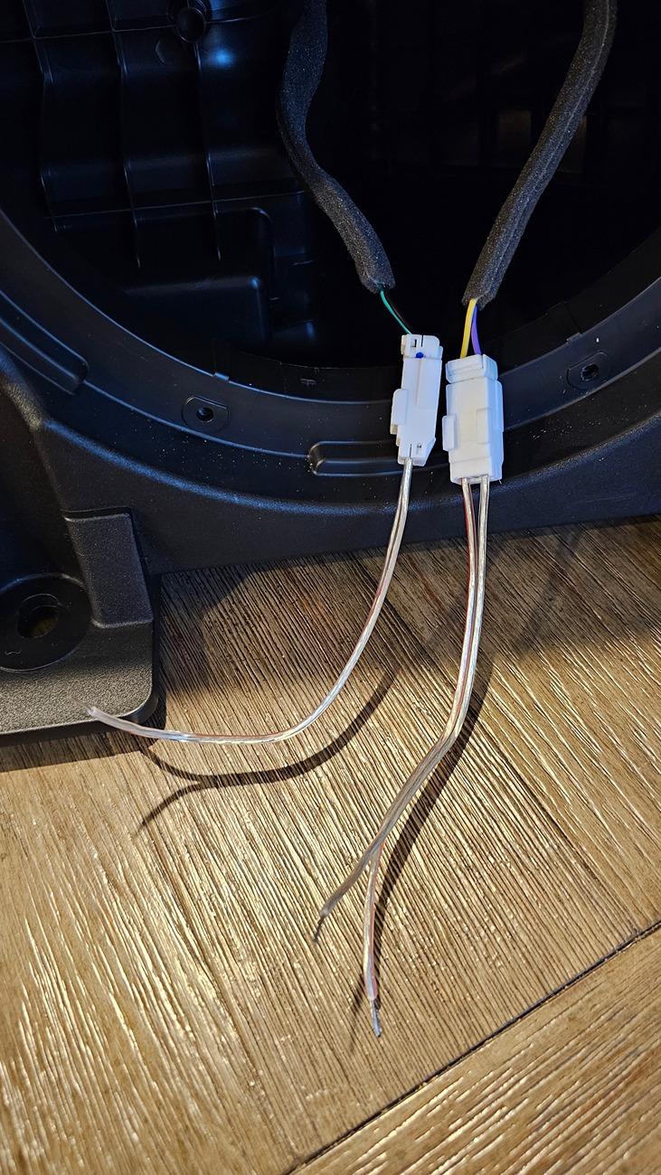

Can also release/pull the original wires out of the plugs and find them having a solid sleeve on their ends.
Still short and need gynecologist fingers to connect them, but doable.
Some info and a video about it is hidden somewhere in the numerous threads.

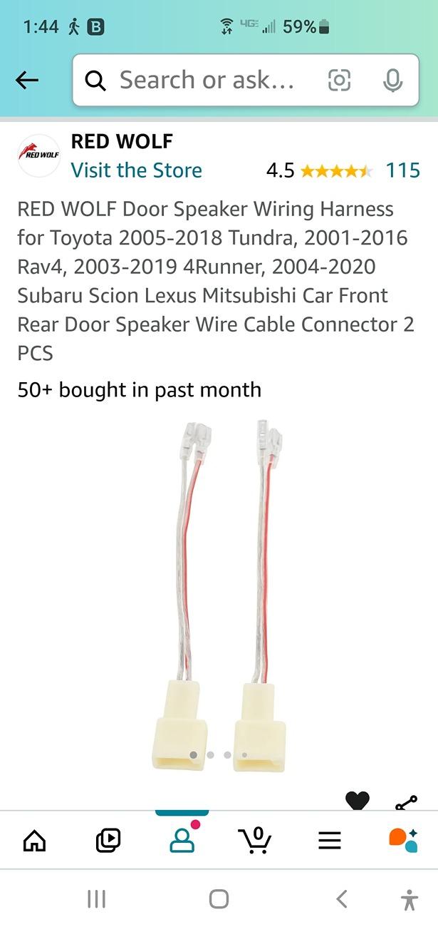

I haven't used them yet but this is what others have used. I don't have a link as I am using my phone app that allows sharing via a text. Its been to hot here for my install. Hope to get at in soon.
2,847
2,902
The Amazon pic and the adapters in @rhstang's pics look different, but that doesn't mean anything.
If anyone else who has ordered these and can confirm they fit the S650, please advise and (if you have it) provide a link to exactly what you ordered. Thanks!
This is the link (https://a.co/d/8FtzkJE) to what i purchased and as mentioned above i cut off the end connectors to fit directly into the speaker terminals

Looks like I ordered the wrong ones. Thanks for the link.
You have keen eye my friend. I am going to reorder the proper ones. I would not have been happy having the wrong ones in the middle of the project.
